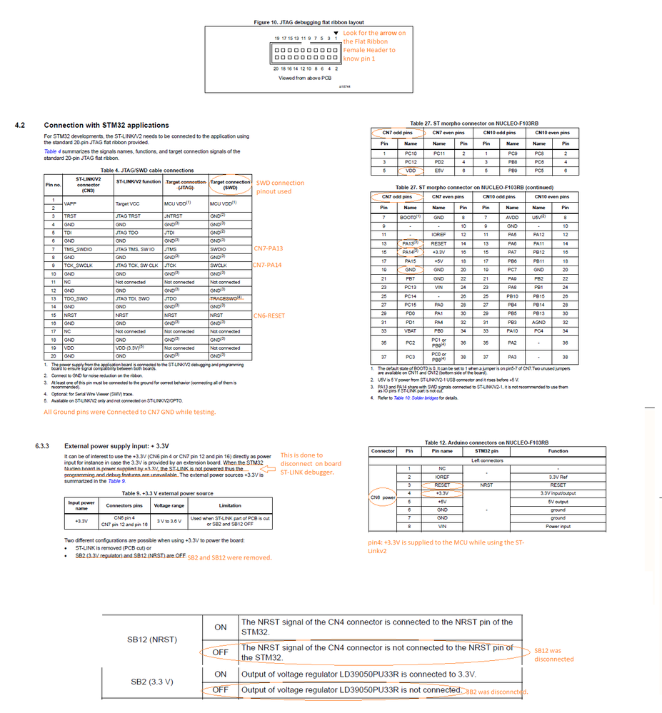

I am programming and debugging Nucleo STM32F103RB using external ST-LINKv2. To use the external ST-LINKv2 I have removed SB2 and SB12 from the Nucleo Board (Please see the Image for the function of specific SB).
I have connected all the pins as shown in the attached image. I am able to program the MCU on nucleo board but it runs when I turn the power OFF and then On(Power on reset I suppose) and it doesn't run when I just load the code to the flash. The program stops running when I press Reset Button B2 on the nucleo board . (I was running the blinky example program)Even when I have to debug the program, I load the code and then turn off and then on the supply and then the debug works. (It doesn't works when I debug right after Loading the code to the flash)

My assumption: The Reset is floating
So what have you done to verify that assumption?
Have you looked at the schematic to verify that the point at which you are attaching your external Reset signal is actually routed to the STM32's NRST pin ?
2018-01-04 3:40 PM
I haven't verified because the assumption is based on the behaviour where the reset gets a low pulse but it does not go high again untill given a POR. I don't know how to verify it. The NRST that I have connected from my ST-LINK/v2 is connected to the internal NRST pin which I have tested by doing a conectivity test. When I press the reset button(B2) the NRST that I have connected to CN6 goes low(0V) and then it turns high(3.3V) when the reset button(B2) is released(This is verified measuring volatages on multimeter).
