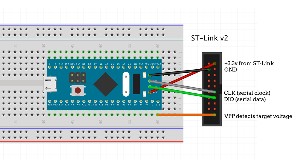

Connector looks backward and upside down
VPP looks connected to pin 1, not pin 19 where it is supposed to be.
Guess it depend what you're looking at. All the docs show the male pin header, not starring into the female connector. I tend to jumper onto the ST-LINK itself with Schmartboard jumper wires or DuPont ones.

This is the connection I'm using except for that I am using except for I'm using the black pill instead of the blue pill in this picture.

I have verified that they are both approximately 3.3V and that the debug pin is connect to gnd to no avail. I'm wondering if there is anything wrong with my debugger since every time I connect to my pc it shows the update firmware option even though I've updated it already.

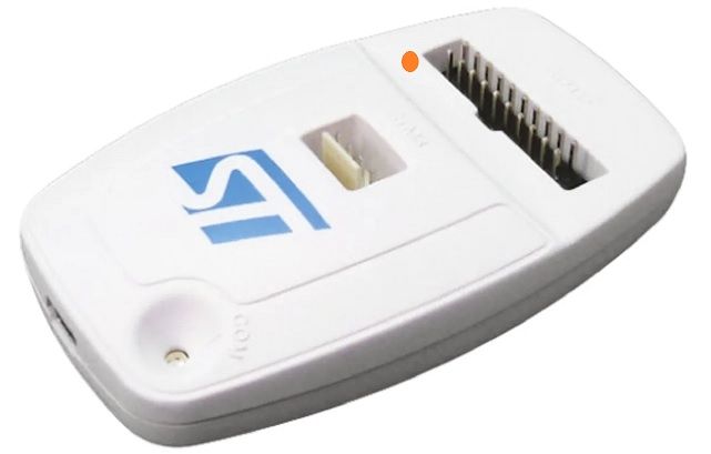

See PIN 1 marked in orange, and where the knock-out is.
PIN 19 is lower left corner, most of the pins on the right edge are grounds.
