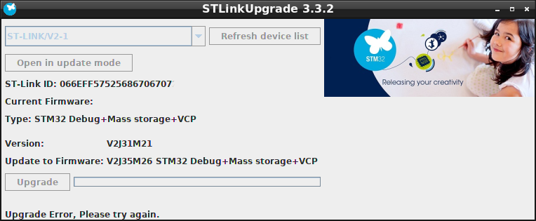

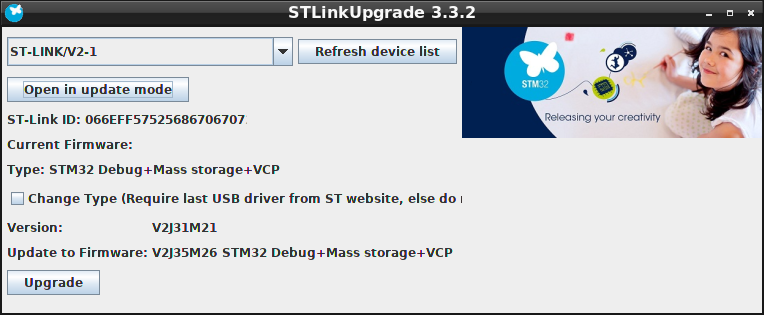

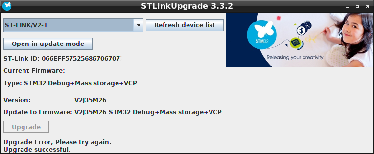

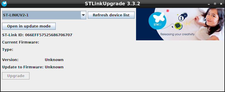

I would hazard to guess a few images to give a better description, in addition I ran a few tests.
I've given images to show what I am seeing.
I ran the upgrade JAR as root. With the same results (had to do some work using Xephyr to have any output but that is a digression).
However additional output from the CLI was available:
"libusb: error [udev_hotplug_event] ignoring udev action bind
libusb: error [udev_hotplug_event] ignoring udev action bind"
was output when attempting to upgrade.
