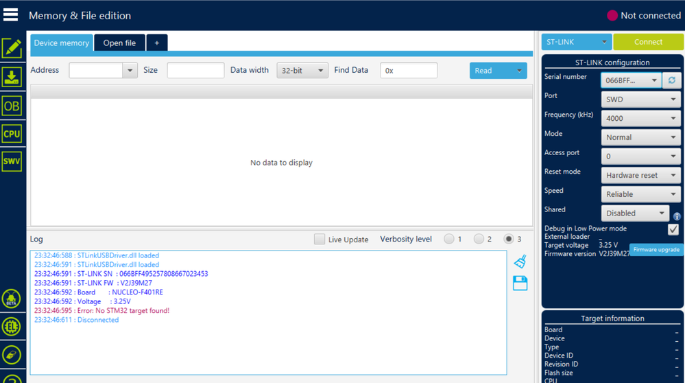

2022-04-16 8:38 PM
Thanks for the reply! I just tried, but STM32CubeProgrammer doesn't seem to be able to connect to the board either using the ST-LINK interface. The error is "No STM32 target found".

Did you reassign the SWD pins?
Try connecting with Mode: Under reset.
