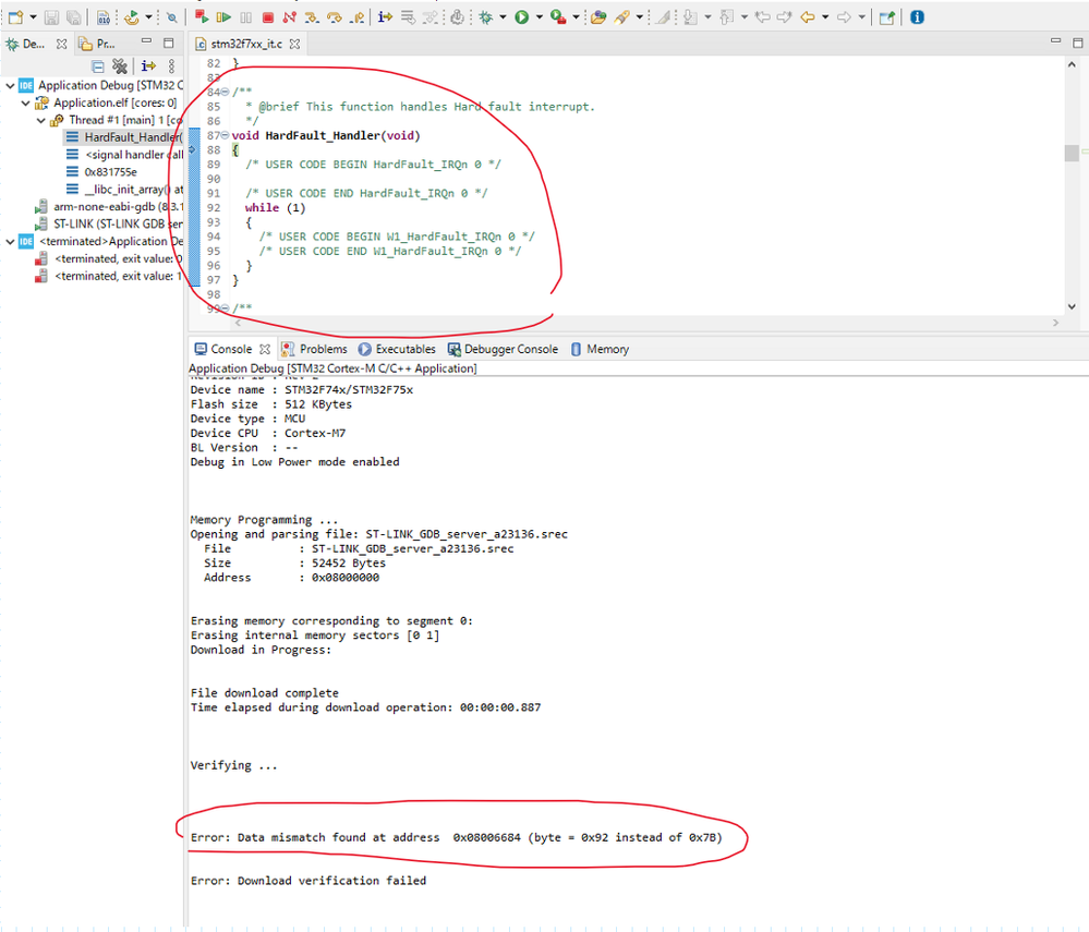

With ST-Link V3:
After download program, go to HardFaul_Handler function and crash.
There is a data mismatch address error when download the code.

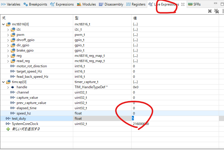

With J-Link:
Program can download. But live expression and expression not work.
Variable does not update when write it.
When the debugger is detached, the value is updated.

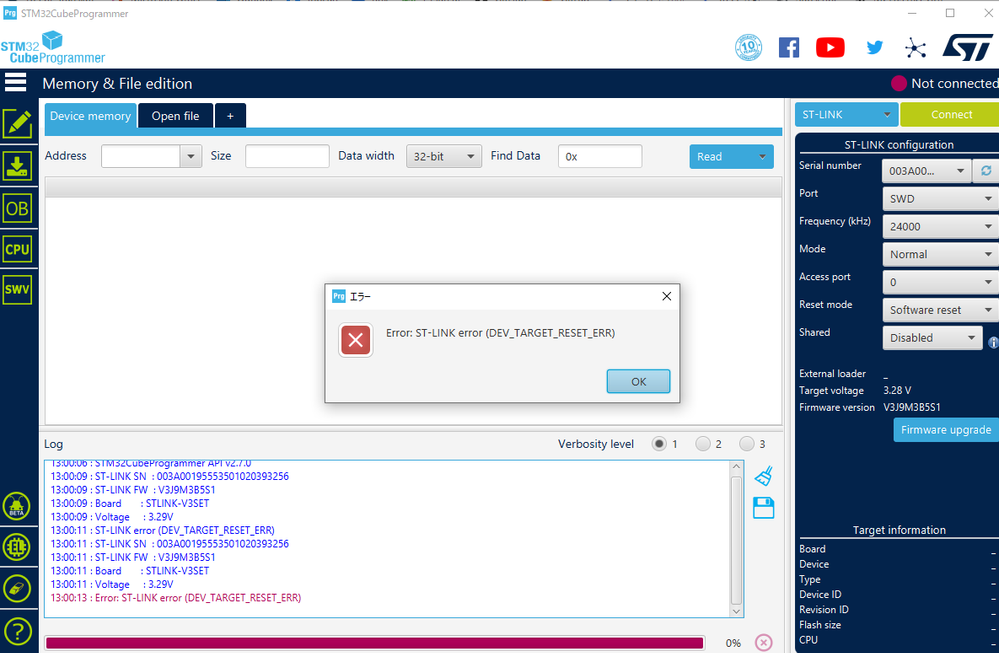

With ST-Link and STM32CubrProgrammer:
Both version of ST-Link outputs DEV_TARGET_RESET_ERR error.

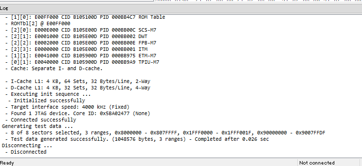

With J-Link and J-Flash app:
Connection is fine.

Hello, I'm having a very similar problem with STM32G070 and CubeIDE V1.8.0.
Using ST Link V2 I can download the program and it shows as verified correctly, however, I cannot use Live Expressions. All of the values show up as 0.
This is somewhat intermittent. I can debug on a board that had a crucial circuit (unrelated to the MCU) ruined during hardware debugging. I've now tried it on two new and identical boards and they will not cooperate with Live Expressions.
