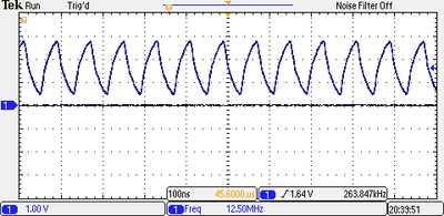

Two STM32H743 series MCUs are on a single board and they communicate using SPI. When SPI clock frequency is more than 1.5 Mhz, SPI communication is not working properly. The distorted clock signal waveforms at high frequencies are attached below.
A 51E series resistor is connected on all 4 signals.
The trace length is almost 35mm
I tried reducing the series resistors from 51E to 33E and 20E. No much difference was observed in the waveforms. What can be done?
1. CLK freq = 1.5MHz
2. CLK freq = 3.125MHz
3. CLK freq = 6.25MHz
4. CLK freq = 12MHz

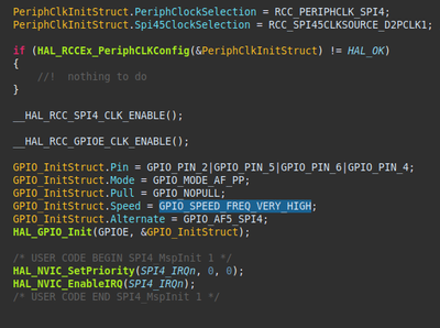

2025-02-20 10:44 PM
Please see the attached image. That seems to be already done.

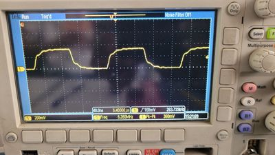

2025-03-04 2:51 AM - edited 2025-03-04 5:20 AM
Yes I checked it with the probe set to 10x.
This is the output waveform of CLK signal set at 12MHz. The DSO reads it to be around 6.25MHz. I used a 330 ohm series resistor to remove ringing. And this is the observed output.
2025-03-04 3:14 AM - edited 2025-03-04 3:15 AM
Then it's around 6.25MHz and the clocks setup in STM32 is not what you think.
> ... ringing
Often, the problem is ground arrangement, but it can also be simply caused by improper probing (ground pigtail on the scope probe, and its placement).
However, even if this ringing would be a genuine artefact of the signal, this amount of ringing is probably not the cause of your original problem. Try to describe what are your observations.
