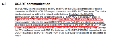

It seems you are using NUCLEO-F103RB.
And this is what is said in the user manual UM1724:
Thank you so much my friend. Big help here. sometimes we overlook highlighted details. Thanks
