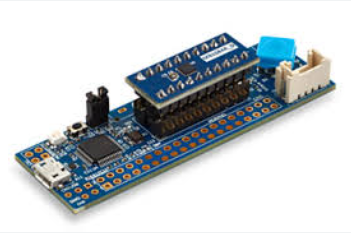

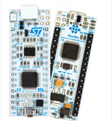

Nucleo-32 format?
Or STM32C0116-DK:

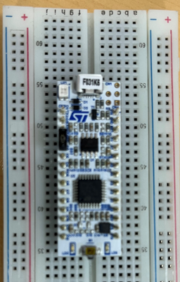

This is the real size on a bread board:

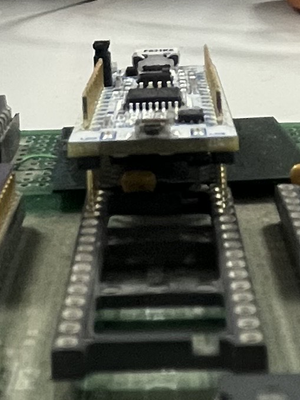

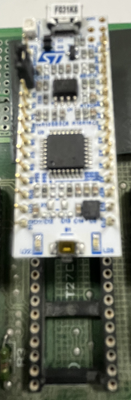

As you can see it fits the DIP-40 socket in width:

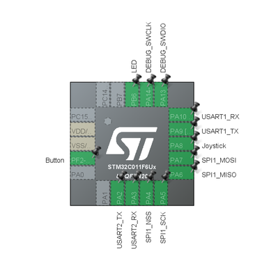

STM32C0116-DK has a daughter board that contains the target C0 MCU that fits DIP-20 socket having 16 IOs available excluding debug pins.
From CubeMx based that board selection:
But still you need to plug this daughter board on the mother board for debug, contrarily to the Nucleo-32 board having the onboard ST-LINK. But you still have the access to the bootloader using USART1 over PA9/PA10.
