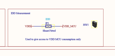

I'm using the NUCLEO-U575ZI-Q board with the PWR_ModeSelection example, and I'm measuring the current consumption with an ammeter through the JP5 (IDD) connector.
The current I measure in the different low power modes is always around 4.52 mA, which does not match the values stated in the datasheet.

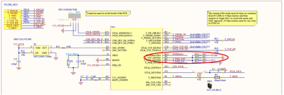

Regarding the connections, from what I can tell by looking at the schematic, it seems that only the SWD pins (SWDIO, SWCLK, SWO) and VCP connect the U575 to the ST-LINK through 47 Ω resistors: R3, R10, R11, R12, R13. But in theory they shouldn't cause any issues...

Yes, they will!
The ST-Link STM32 is not powered, so you will be leaking some power back into it.
In most cases, that's not noticeable - but, when you're worrying about ~ 2 µA, they become significant !
There will also be a connection to the ST-Link to measure VTarget ...

When JP5 is removed and VDD_MCU is used as power ( UM2861, 7.4.1 VDD power supply input ) then Vtarget (VDD) is no connected to the stlink
2025-10-22 3:17 AM
