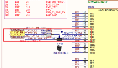

If you are using Virtual Comport of STLINK, this is normal as USART1 is not connected to the VCP but USART3.
So use USART3 instead with the correct Tx/Rx pins.
Please review the board schematics before suspecting an issue in the software.

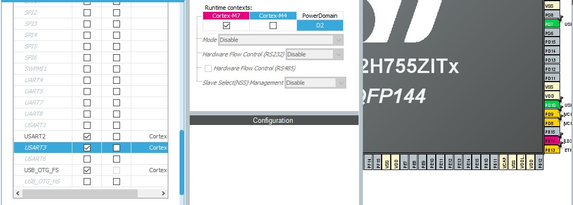

thank you for the response, I was searching virtual com port and not vcc so I did no see it. however I got another problem on stm32: USART mode 3 is impossible to put the mode into available:
I wanted to do it manually by turning directly the pins of PD9 and PD10 into tx nd rx but it doesn't want to turn on the usart3. I think I am missing something.

This reply is late but I hope it will be useful for future reference for other users, since the original one didn't help me, but I managed to get it to work.
Even when you can't turn on USART3 via Cube MX, you can still turn it on via software in your main.c. Just manually add the config for USART3, for example:
static void MX_USART3_UART_Init(void)
huart3.Instance = USART3;
huart3.Init.BaudRate = 115200;
huart3.Init.WordLength = UART_WORDLENGTH_8B;
huart3.Init.StopBits = UART_STOPBITS_1;
huart3.Init.Parity = UART_PARITY_NONE;
huart3.Init.Mode = UART_MODE_TX_RX;
huart3.Init.HwFlowCtl = UART_HWCONTROL_NONE;
huart3.Init.OverSampling = UART_OVERSAMPLING_16;
huart3.Init.OneBitSampling = UART_ONE_BIT_SAMPLE_DISABLE;
huart3.Init.ClockPrescaler = UART_PRESCALER_DIV1;
huart3.AdvancedInit.AdvFeatureInit = UART_ADVFEATURE_NO_INIT;
if (HAL_UART_Init(&huart3) != HAL_OK) {
Error_Handler();
if (HAL_UARTEx_SetTxFifoThreshold(&huart3, UART_TXFIFO_THRESHOLD_1_8) != HAL_OK) {
Error_Handler();
if (HAL_UARTEx_SetRxFifoThreshold(&huart3, UART_RXFIFO_THRESHOLD_1_8) != HAL_OK) {
Error_Handler();
if (HAL_UARTEx_DisableFifoMode(&huart3) != HAL_OK) {
Error_Handler();
}and then use huart3 as usual for printing to serial port. It works well.
