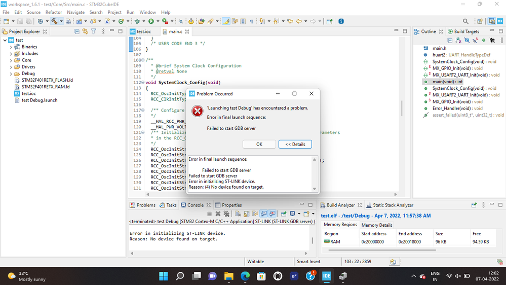

we are facing some issue with ST microcontroller and ST-link debugger help me out from this issue.
GDB server error and below its showing, Target no device found
Error in initializing ST-LINK device. Reason: No device found on target. when im try to flash program and debug at the time its showing this error using the USB type st-link debugger.

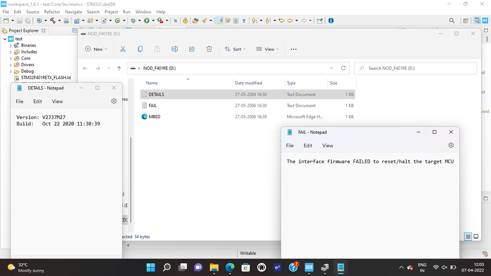

And some other issue also we are facing in stm32 nucleo-F401RE like The interface firmware failed to reset/halt the target MCU.
ill attached screenshot in this place find out..

Error in final launch sequence:
Failed to start GDB server
Reason: (4) No device found on target.
