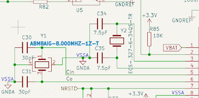

Show LSE schematics part.
Sourabh
Associate II

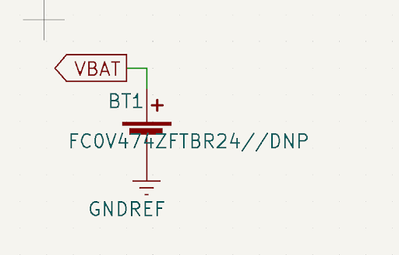

Hi everyone,
Here is how my LSE and my supercapacitor is connected to VBAT.
Hi everyone,
So this is your supercap: https://www.yageogroup.com/products/Capacitors/part/FC0V474ZFTBR24
You haven't shown how it gets charged, or how you manage the discharge.
