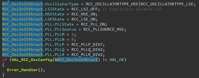

  • Tried fully resetting the RCC using:__HAL_RCC_BACKUPRESET_FORCE();
    __HAL_RCC_BACKUPRESET_RELEASE();
  • This allows the clock to reinitialize, but the stored RTC time/date are lost.

Hi thanks for the reply, the clock doesn't configure the second time, and is there a way to check my LSE state during my clock initialization?
waclawek.jan
Super User
I don't use Cube so can't help with that. However, Cube is open source, so you can debug it as your own code.
You can check state of the clocks in the respective RCC registers, namely, LSE state is given by the LSERDY bit in RCC_BDCR. You can do this in debugger, too.

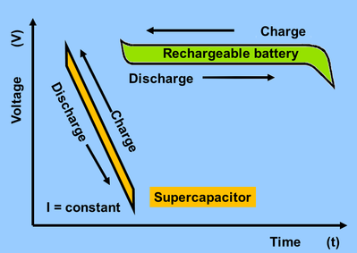

Remember that Supercaps are not like batteries: the voltage decays gradually to zero - unlike batteries, which tend to keep a (relatively) steady voltage until they die:
#SuperCap #SuperCapVsBattery
