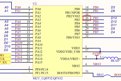

@DSebastian Although not shown in that table, there is also another "pin number" involved:  that's the number of the physical pin on the microcontroller's 32-pin LQFP (or UFQFPN) package - in this case, it's pin 26:
But, again, the executing code knows nothing of this external hardware detail - all it sees the the Port (GPIOB), and the pin number within that port (3).
