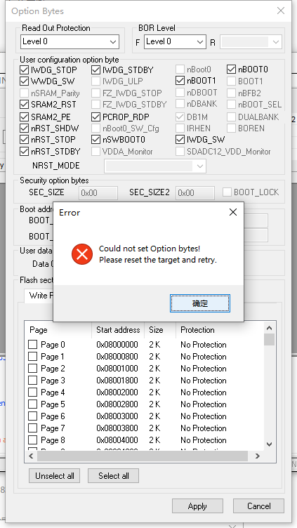

When preparing to set the option byte, it is found that the read protection setting is at level 1 and cannot be changed to level 0. Then, it cannot be applied when preparing to apply, as shown in figures 5

Try to set RDP option byte to 0xBB (level 1) and then back to 0xAA (level 0).
Please let me know if this solves your problem.

Thank you for your reply. When I download the program using stm32cubeprogrammer according to your suggestion, I still prompt "error: failed to erase memory", so I think the read-write protection should be cancelled. Is there any way to solve it? I haven't met in other development boards yet

According to the above suggestions, use stm32cubeprogrammer to set the RDP value to FF, and then restore it to AA value. The problem of read protection has been solved. Thank you very much.
