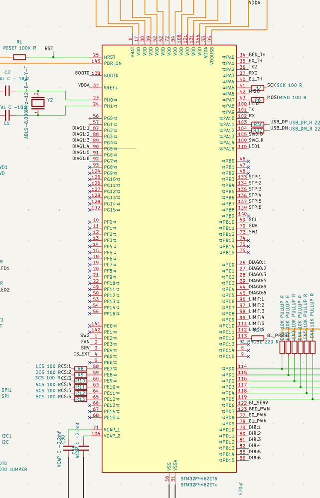

Also, your PA11/PA12 are swapped. PA11 is USB_DM and PA12 is USB_DP. Brings into question how USB is working at all.

As for the swapped PA11/PA12, yes good eye, I made a mistake in the schematic drawing, so on the board they’re physically crossed to accommodate for my *** up, so the wiring to the USB connector is correct.
