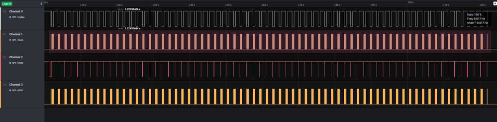

I measured with the Logic Analyzer. Thats the result:
The most time is lost between two 500kB chunks (>1.2s). The transfertime of one 500kB chunk is less than 0.6s. For 32MB it tooks about 2min to transfer.
@Khouloud GARSI : Is there a possibility to reduce the time between the 500kB chunks?
