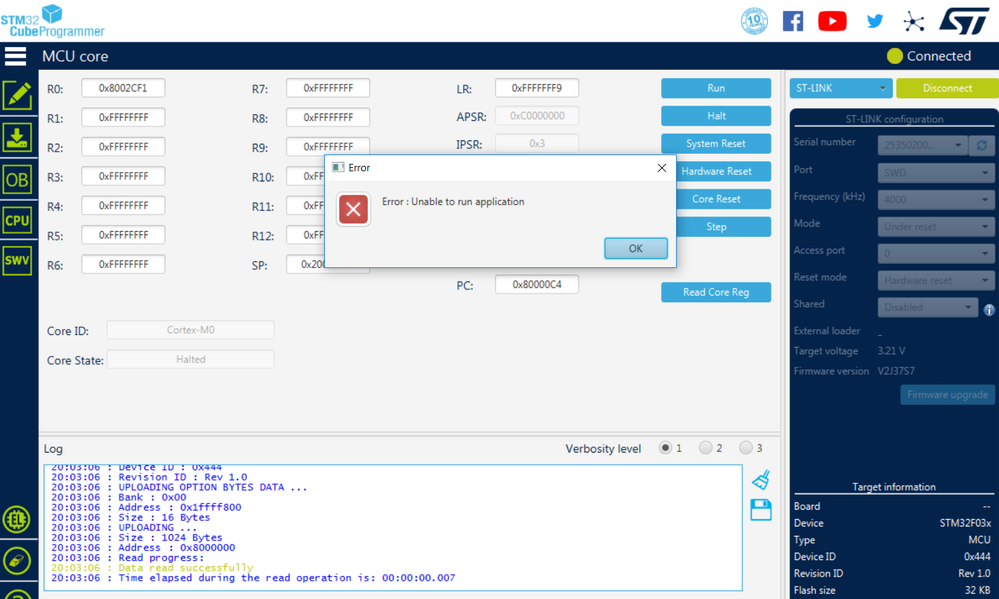

Thanks for your reply, here is a screenshot
why do you prefer to use STM32CubeProgrammer? shall I also read the flash memory again with it?

I don't see a screenshot in your post.

I'm not sure what "Run" in that box is supposed to do. Without a debugger attached, the chip will run on its own. Within STM32CubeIDE, you can also run the code. You don't need to tell the chip to run. Once you provide it power, it will run, assuming it's not halted from the debugger or in reset.
