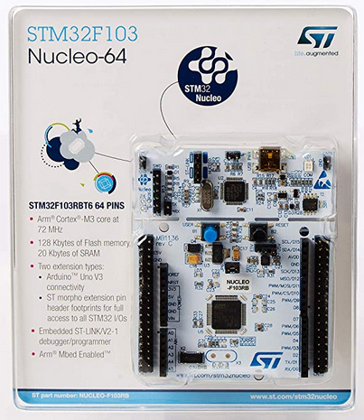

I have, or will shortly have, three different ST-Link v2 devices. The first one us built into my Neuclo-64 for the STM32F103RB Nucleo-64 board. I know I can use the ST-Link from the Nucleo-64 board on other ST32 devices by separating it from the rest of the board and repositioning some jumpers. However, I didn't fancy separating that ST-Link from its board because, once separated, there are porcupine connectors top and bottom and no case, so not very ergonomic.

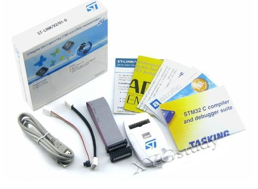

I purchased a genuine ST-Link/V2 branded from ST, the one with the stylized white plastic case. But this one only has a 4-pin and a 20-pin connector (and the 4-pin connector will not match the blue pill.)

With the four pin cable you show on the picture at top, you can go a long way. E.g. connect the top four pins of the 6 pin connector (with the jumpr removed) to the four pin connector of another nucleo or discovery board. That way with a nucleo you can debug other boards without breaking away the debugger.
Or you look at the pinout of the debug connector of Stlink clone or the genuine Stlink and connect those again to the four pin connector of a foreign Nucle/Disco/...
The four pin connection (VCC/GND/SWD/SWCLK) is the minimum, on sone situations you also need Reset and SWO is fine for tracing.

The boot-leg device is using a cheap 5x2 header connector, probably don't follow the MikroE "standard", they had an adapter and 10-pin ribbon cable with IDC connectors. The boot-leg is likely an ST-LINK/V2 variant. ie smaller F103, no VCP, no MSC
The Nucleo has the ST-LINK/V2-1 variant, supporting the mbed MSC, and also a UART/VCP
The 20-pin ARM JTAG connector is a standard. They have a newer higher density 10-pin SWD standard.
ST made up their own, and they also have a variant of the ARM 10-pin, which expands to 14-pin, with a pair of additional pins added at both ends to provide for a UART/VCP
