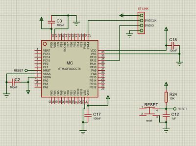

Hi all,I have a custom board, with a STM32F303CCT6, but I cant to connect with ST-LINK.For simplicity, I only soldered the MCU, the 4 capacitor on the power pins and the reset circuit. I tested with BOOT0 to GND and to VCC, but nothing works.I tested...
Console says:ST-LINK detects target voltage = 3.25 VST-LINK device status: HALT_MODEST-LINK device initialization OKhandle_vCont_c, continue threadTraceCaptureStart and SWV event set to APP_FALSE (0)NVIC_DFSR_REG = 0x00000008Debugger Console says:Pro...
Hi all,Could this minim circuit to connect with ST-LINK??MISTAKE - In the drawing, the SWDIO must connect to PA13, not PA12!!!!!
