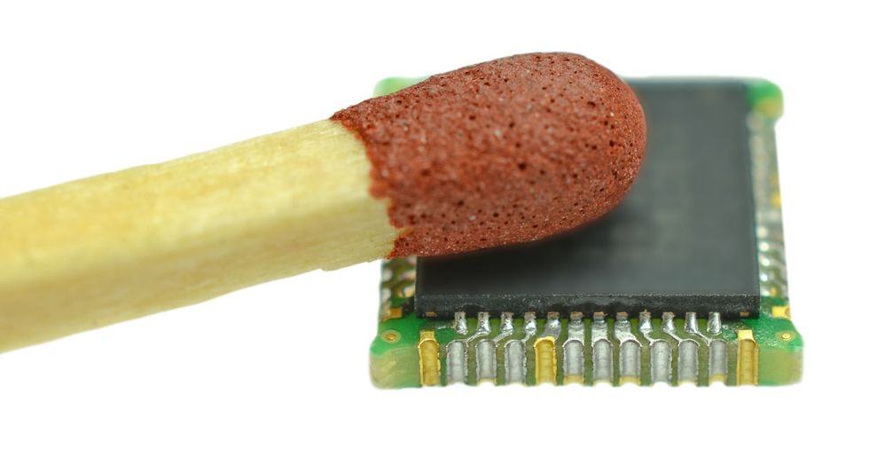

I'm waiting for a STM32L4 LQFP48 micro that also includes a DFSDM to become available, it's not urgent and I've got plenty of other things to do. But I have noticed there are a lot of QFN48 parts available. Maybe ST could make an adapter as described on this German web site ( https://www.kuttig.de/news/elektronikfertigung/qfn-adapter-die-letzte-rettung.html ) . The adapter they made converts different pitches, so it would be easier for the STM packages which have the same pitch. If by some miracle ST thought this was a worthy idea, I would suggest the adapter is largely blank on the bottom layer - one of the things I like about the LQFP packages is that I can sneak some power traces under the micro.
