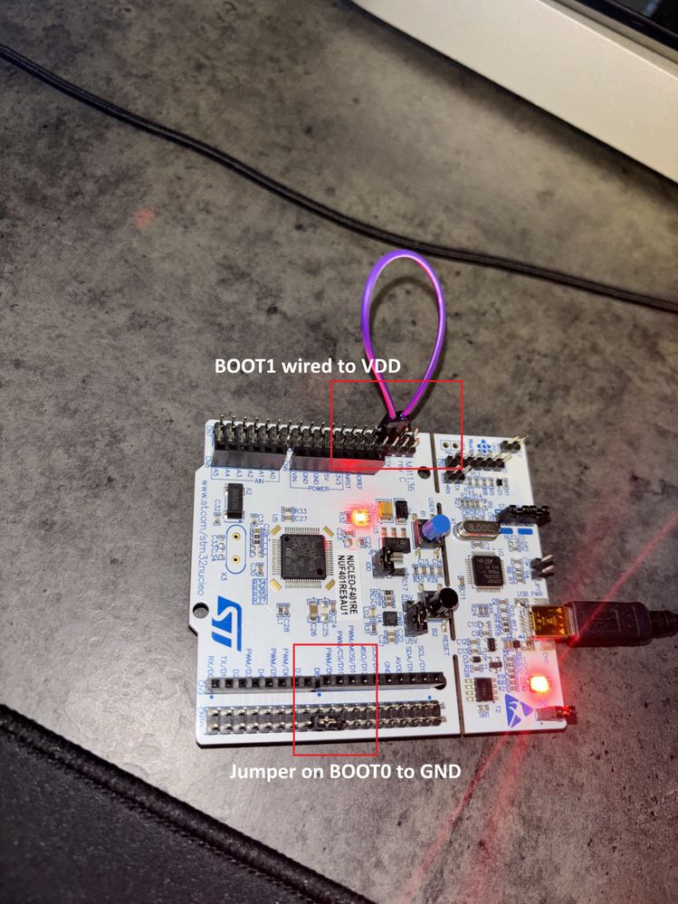

LD1 is red after plugging in the USB, and the board gets power through the USB. I have wired BOOT0 to VDD and pressed the reset button, then tried to connect over SWD in CubeProgrammer but still "no STM32 target found". There is no other wiring setup on the board other than BOOT0 to VDD. I also tried wiring BOOT0 to 3V3, but same result.
This problem only occurred after I re-assigned PA14 & PA13 and disabled SWD through CubeIDE, and then flashed the chip (on accident).

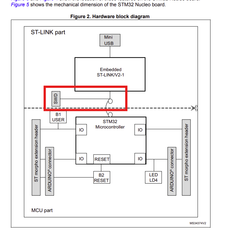

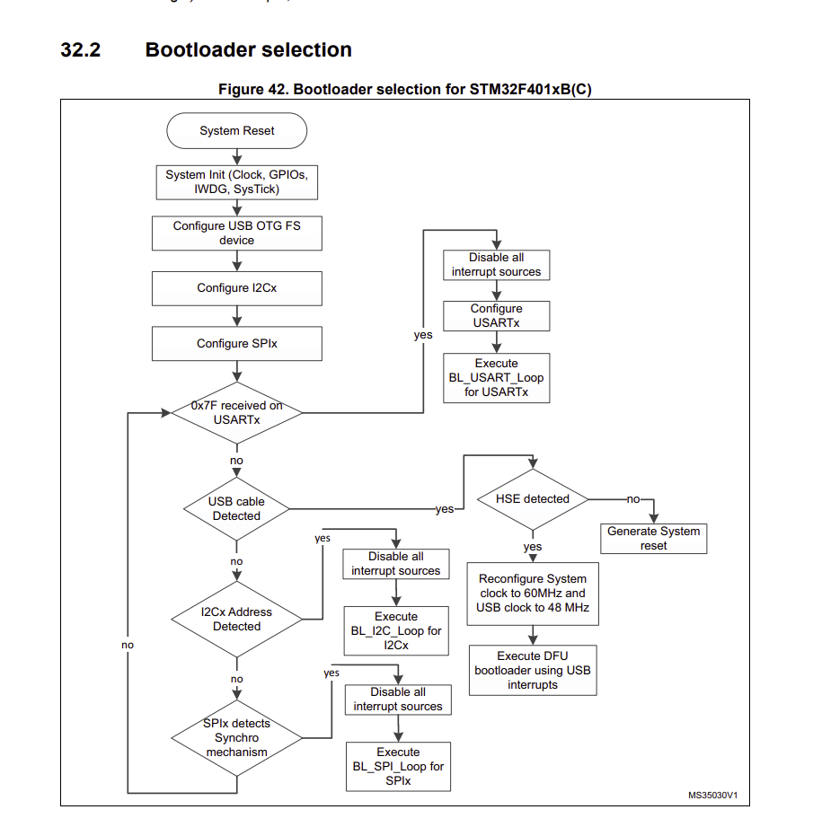

The Hardware Layout for my Nucleo board also states that ST-Link is only available over SWD. Could it be that the system bootloader doesn't actually start SWD?
In AN2606 I don't see any mention of SWD being available in sys bootloader:
If useful, here is my setup:
Thanks in advance for any insight!!
No, SWD is part of the cortex core, not the bootloader. The only way to disable it would be to set RDP 2.

I’m out of ideas though, my last idea would be to check UART1 pins with a logic analyzer to see if the MCU actually runs the bootloader?
