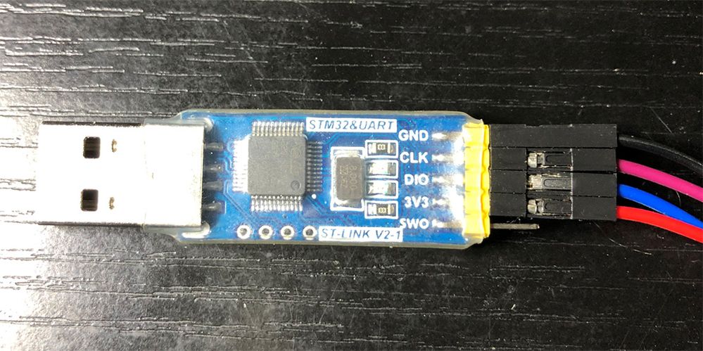

The ST-Link programmer you have is not an official programmer. It's an even lower cost knock-off. But it probably works fine. I don't know if the 3V3 on your programmer is intended to power the board. I suspect it is. Whereas in the official programmers, the board needs to be self-powered. This is an important difference.
Try to only connect GND, SWDIO, and SWCLK. Official programmers also connect NRST but it is not strictly needed.
Here is a link with programmer schematic info:
http://www.keil.com/support/man/docs/ulinkplus/ulinkplus_jtagswd_interface.htm

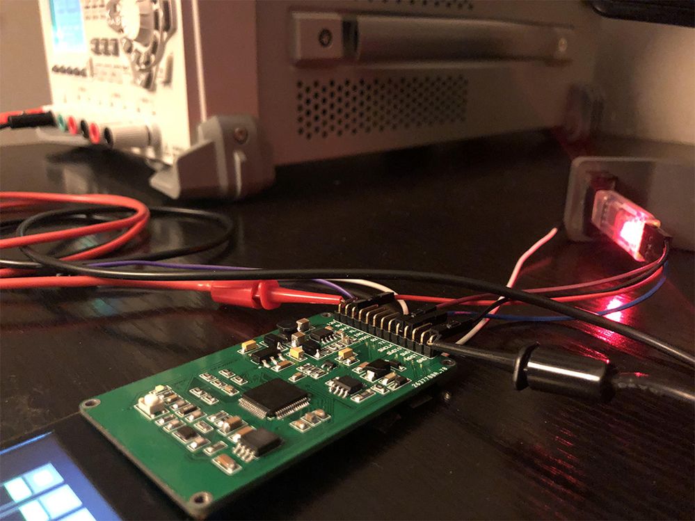

> with the exception of being able to program (ST-Link) while external power is applied
Post photo of your setup.

Sure. Not much going on in all honesty other than;
1) External pwr (24V to 5V) Step-down feeding a LDO (3V3)
2) PC/Programmer connecting to 3V3, SWCLK, SWDIO, GND
2020-05-02 5:02 AM
Tried connecting SWCLK, SWDIO, GND and leaving 3V3 disconnected and that didn't worked out. Still getting current going to the programmer. Tried a diode on the prog GND to prevent that and that didn't do anything.

I have a feeling what you are trying to say is that the programmer I am using might/could be the issue ;) Attached is what I was given by the IC supplier, told me this is all what I needed to get balls rolling. Do I need to get myself an official ST-LINK V3 or similar to get External Power to work with PC/USB?
Given I might use the same SW interface on the official prog (i.e. SWCLK, SWDIO, 3V3, GND), would the end result (fault?) not be the same as this V2.1?
