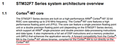

If you need a shared routine between the two cores (just an algorithm): theoretically yes.. But you need to do the test. Refer to the AN4667 / paragraph 1.1:
2024-03-20 4:52 AM - edited 2024-03-20 8:30 AM

This is good beginning. The core of the question was about the following - do M4 and M7 cores share one and the same program memory (common address space) ? And if YES, if for M4 some address is 0x1000, is it the same for M7?
Best reagdrs
2024-03-21 6:39 AM
Hello;
The flash memory is shared between the two cores and the flash addresses are seen in the same way.
