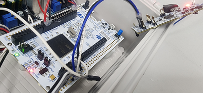

I cut the STlink board from Nucleo-F722ZE board.
I connected the cut STLINK board to the nucleo board and SWD.
To connect swd, I connected 2 (JTCK), 3 (GND), and 4 (JTMS) of the SWD connector to 13(PA13), 15(PA14), and 19(GND) of the CN11 connector of the nucleo board.
SWD con. 2(JTCK)   -   CN11 con. 15(PA14, TCK)
SWD con. 3(GND)   -  CN11 con. 19(GND)  <--- Common Ground between boards.
SWD con. 4(JTMS)  - CN11 con. 13(PA13, TMS)
The power source for the nucleo board was 5V input from the outside using 6 (E5V) and 8 (GND) of CN11.
And the cut stlink board was connected to the PC via USB.

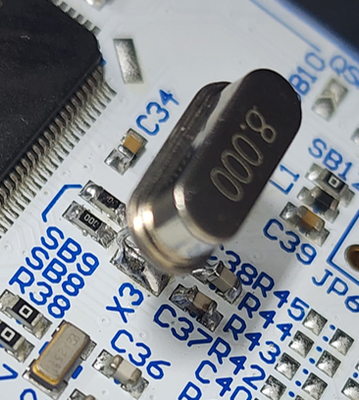

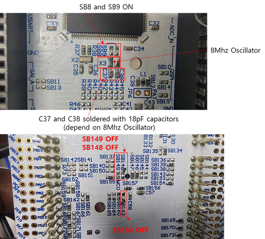

And for the "HSE on-board oscillator from X3 crystal(not provided)" that is not provided,
I processed it as follows.
X3 soldered with 8MHz crystal.
SB8 and SB9 ON.
C37 and C38 soldered with 18pF cap.
SB148, 149, 163 OFF.
SB112 was not processed separately as it was on the stlink board.chulhoolimnnftech_2-1725847933580.png

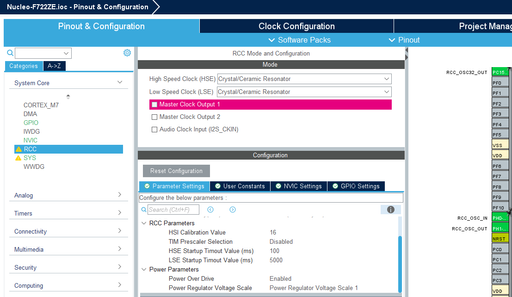

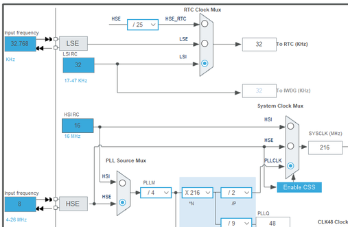

And I set the RCC and clock configuration as follows:

Ok, but what's actually wired up here? Describe, don't just post pictures.
Common Ground between board pieces?
