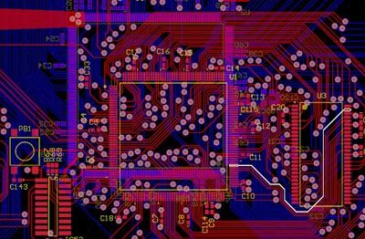

I have a design that I am happy to make public if anyone is interested. The complete PCB has 2X429’s (176pin) and 2 Cycloneiii FPGA’s. The reason I haven’t already is there are a few things that need to be fixed in the next version i.e. 6 layer PCB not 4, when designing DMA’d GPIO’s triggered by a Timer you need memory to memory DMA channel not memory to peripheral, JTAG RST error. But other than these, the design as working well beyond my expectations. So whilst it isn’t perfect (yet) it could act as a base to someone designing their own.
Also have looked at githum and sourceforge but these seem to be software rather than PCB design.
The design is in Altium but could screenshot the separate pages although the filesize limit on the forum is a problem.
I have managed to export the data to a pdf and will try and attach it.
2014-05-01 1:49 PM
Wow, that seems to have worked.
Clive, for all the help you have given me with your various posts I will happily send you one of my spare boards populated (with one CPU and FPGA, as that’s all I have spare at the moment) to your requirements if you want it, gratis.
