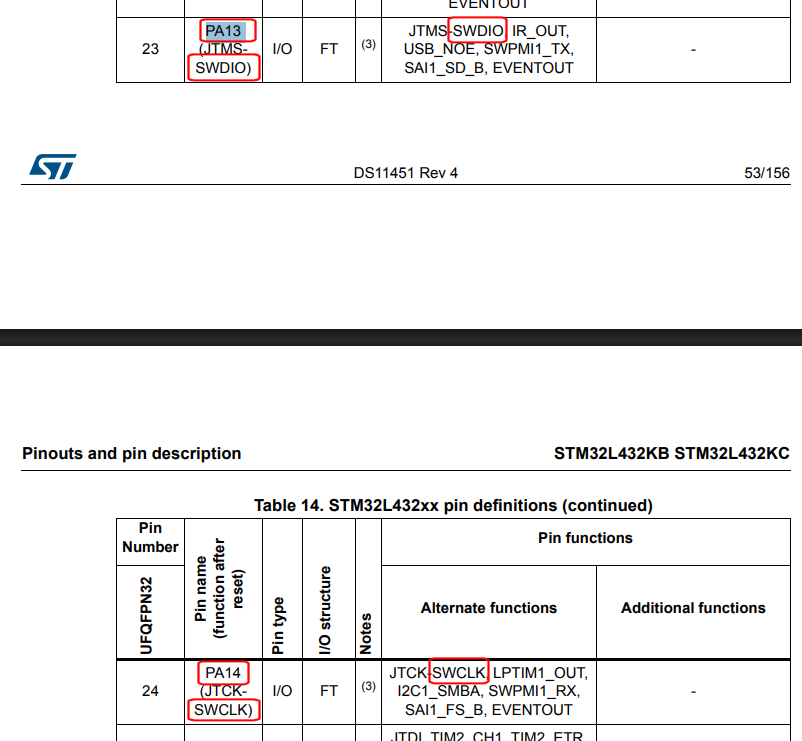

@TVan .8 wrote:I want to acces pin PA13. But I can find no connector or easy acces point.
Note that PA13 is the SWDIO pin - so using it for anything else will interfere with your ability to program & debug the chip ...
Also PA14 is SWCLK:
https://www.st.com/resource/en/datasheet/stm32l432kc.pdf#page=53
via: https://www.st.com/en/microcontrollers-microprocessors/stm32l432kc.html#documentation

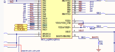

2026-02-06 8:52 AM
The board schematic is here.
As said by @Andrew Neil PA13 corresponds to the SWDIO pin. So need to take care about that point.
