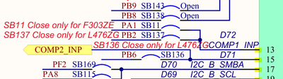

Where exactly are you measuring it? It's not exposed on a header.
If you are measuring on CN9 pin 13, you will need to close SB11 which is open by default.

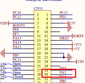

Not exposed on the Zio connector
But exposed on CN11 (Morpho connector not mounted by default on the board):
