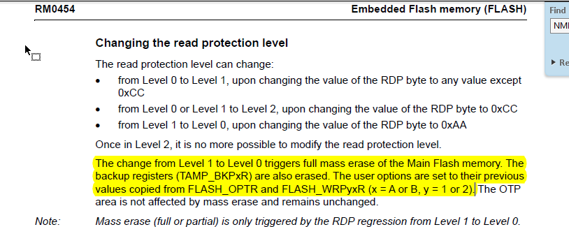

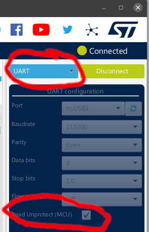

Strangely, I tried using the UART bootloader (stm32flash or STM32CubeProgrammer v2.6.0 command line) and it appear to be able to remove write protection and program the MCU, but in reality it does not and problem remains.
However, adding read protection was possible through STM32CubeProgrammer GUI. I connected by SWD to the MCU and set read protection to level 1. Point of this is that this should cause an MCU internal flash erase operation (does not need debugger) if a read operation is attempted. Now how to trigger that, I found that if I connect by STM32CubeProgrammer GUI in UART mode (see picture below), it gives the option of 'read unprotect (MCU)' which triggers the flash erase operation. This actually fixed my issue and my MCU is alive again.
UPDATE:
It is possible to do this without the UART bootloader in command line with these commands:
STM32_Programmer.sh -c port=swd --optionbytes RDP=0xBB (to enable read out protection)
STM32_Programmer.sh -c port=swd -rdu (to trigger mass erase)
The 'read unprotect' option is available also in DFU mode (at least).
2021-10-05 7:53 PM
Thanks for your post, this helped me undo write protections that I had set on my MCU.
In my case, there was no need to use your "connect under UART" step --> all I needed to do was toggle RDP to level 1, change WRP bits, then toggle RDP back to level 0 to get back to normal.
