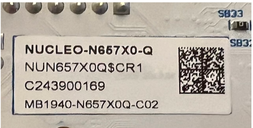

All seems to be correct in the last pictures you shared.
Could you confirm the backside stickers of the board?
Best regards,
Romain,
2025-04-26 1:01 AM

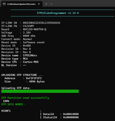

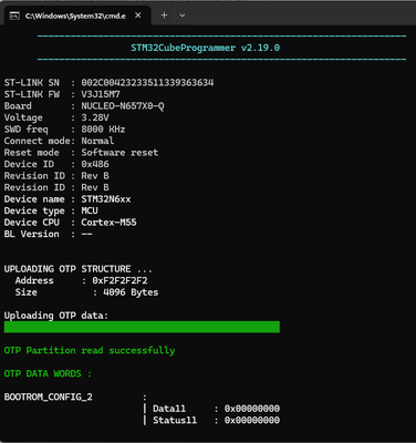

2025-04-26 9:22 AM - edited 2025-04-26 9:23 AM
Thank you for the picture, I used the same CR4 versions to program your signed binaries.
Your hardware seems to be correct for me.
Let's check OTP11 and OTP124 configuration of your Nucleo board.
OTP124: HCONF1 here the Bit 15 HSLV_VDDIO3 and Bit 16 HSLV_VDDIO2 are set
In the last solution you can follow this Knowledge Base article to flash OTP124 0x0001 8000:
https://community.st.com/t5/stm32-mcus/how-to-program-the-otp-fuse-bits-in-the-stm32n6/ta-p/782353
In attachment, you can try to use the bat script to sign and flash your binaries using STM32_Programmer_CLI.exe.
