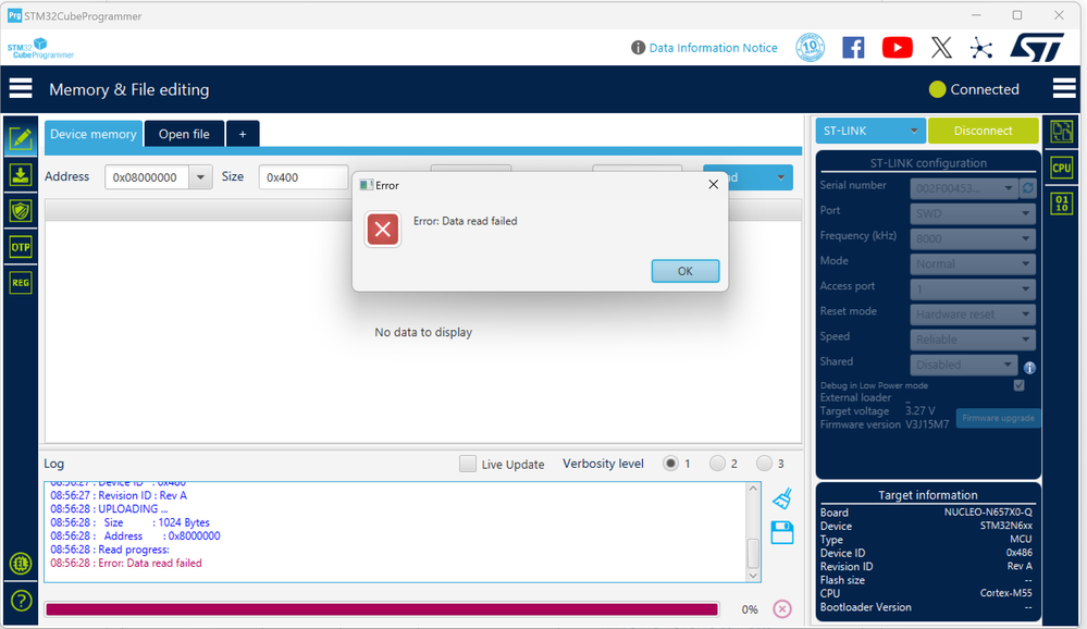

The STM32CubeProgrammer (v2.18.0) is also unable to program any binaries on the board. After changing the Reset Mode to "Hardware reset" I am able to connect to the board, but immediately get the error message:
15:09:28:207 : UR connection mode is defined with the HWrst reset mode
15:09:28:364 : ST-LINK SN : 002F00453433511830343835
15:09:28:365 : ST-LINK FW : V3J15M7
15:09:28:365 : Board : NUCLEO-N657X0-Q
15:09:28:365 : Voltage : 3.27V
15:09:28:365 : SWD freq : 8000 KHz
15:09:28:365 : Connect mode: Normal
15:09:28:365 : Reset mode : Hardware reset
15:09:28:365 : Device ID : 0x486
15:09:28:365 : Revision ID : Rev A
15:09:28:365 : reset ap 1
15:09:28:365 : Reading data...
15:09:28:365 : r ap 1 @0x00000000 0x00000004 bytes Data 0x00000018
15:09:28:365 : Database: Config 0 is active.
15:09:28:461 : UPLOADING ...
15:09:28:461 : Size : 1024 Bytes
15:09:28:461 : Address : 0x8000000
15:09:28:462 : Read progress:
15:09:28:462 : Reading data...
15:09:28:462 : r ap 1 @0x08000000 0x00000400 bytes Data 0x00000018
15:09:28:541 : r ap 1 @0x08000000 0x00000400 bytes Data 0x00000011
15:09:28:541 : Error: Data read failed

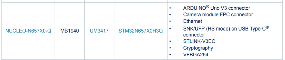

Unfortunately link to user manual UM3417, which is https://www.st.com/resource/en/user_manual/dm01122391.pdf (per STM32 Nucleo-144 boards data brief) is currently unavailable.
I don't understand what I am doing wrong from the error messages, and can't access the user manual. I would appreciate if someone can shed light on the issue I am seeing.

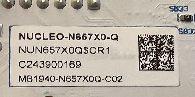

Could you confirm the revision of your Nucleo board indicates on the bottom stickers, something like:
MB1940-N657X0Q-C01

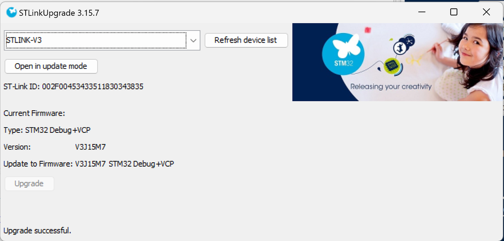

Hi @cersoy ,
Try to perform an STLink upgrade from STM32CubeProgrammer.
Regarding the user manual, it should be this one: Data brief - NUCLEO‑xxxxLx/xxxxXx/xxxxZx(-P/Q).
Where do you find the wrong link? Please let me know to fix it.
-Amel
2024-12-25 6:15 AM - edited 2024-12-25 6:17 AM
Thank you Amel for your prompt response. On page 6 of the document you pointed out, there is a link to the user manual of this specific board:
link to UM3417 does not work.
I upgraded the STlink from the STprogrammer per your recommendation. Below are the snippets:
But still no success accessing the board:
Are there any diagnostics I can collect to troubleshoot the problem. Thanks again for your help.

2024-12-26 4:18 AM - edited 2024-12-26 4:21 AM
Thank you @RomainR. for the detailed explanation. Below is the information you requested:
Changing the position of jumper JP2 (BOOT1) from default 0 to 1 (as you suggested) fixed the issue on my side. I am able to connect to board using the STprogrammer, upload binaries using the debugger, and stepped through the code.
The example I was using has the the linker script STM32N657X0HXQ_AXISRAM2_fsbl.ld, which locates the binary at 0x34180400 with the label ROM, that is indeed SRAM2 not flash.
The descriptions of the jumpers on NUCLEO-N657X0-Q was the information I was missing and the PDF attached to your reply helped me resolve the issue. I'll refer to the reference manual STM32N6 (SoC) and the SDK examples for other boot modes supported.
