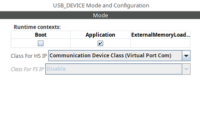

I just tried: make CDC on H7S3nucleo , core at 360M , just in Cube set USB_HS:

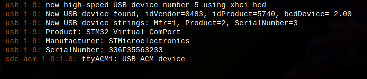

first try, connect to PC (LinuxMX) :
So Cube seems working as it should.

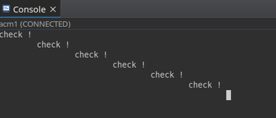

And can see connected working:

I tried to import your .ico file, but I get a build error. Missing "buf" in linked_list.c. Anyway, I notice that your configuration does not use boot, it only has the application. I am only using boot as I want to use the internal flash memory and won't exceed its size. Could that be an issue?
no, just set all you want for the "boot" then.
