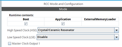

Did you set it like this ?

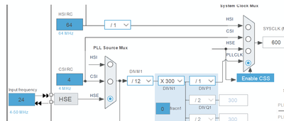

+ in clock tree set the 24M
It should work then. (My H7S3 does.)

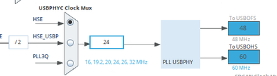

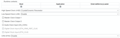

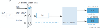

... and USB:

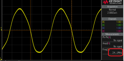

May be you need to check OSC_OUT pin with an oscilloscope:
I suspect an issue in your board.
Do you have another board that you can run the test with?
2025-10-07 5:28 AM
AScha.3 that works for me too. mƎALLEm I can see a 24MHz sine wave on that pin.
I have made some progress though. I found that certain settings that CubeMX says are okay don't actually seem to work. I initially had the HSE divided by 12 into the PLLs. Changing it to divided by 2 (and adjusting the multiplier to give 600MHz) allows it to get past setting the system clock.
It's odd that the timeout is with setting up the HSE rather than the PLL, and odd that it works for other people. I will continue to investigate.
