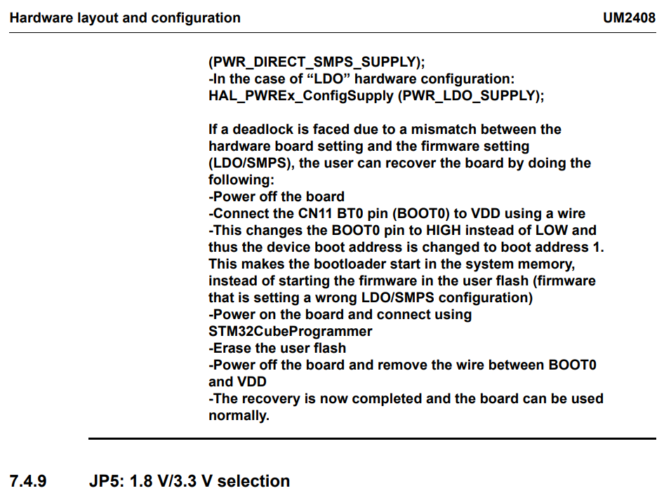

2025-02-13 2:05 AM
A possible explanation (and slightly simpler remedy) for this is mentioned in the manual, section 7.4.8:
The remedy on page 26 can be interpreted as just:
- Connect CN11 pins 5 (BOOT0) and 7 (VDD).
- Start Cube Programmer with USB cable attached to CN1 as you would normally.
- Full Chip Erase
- Power down.
- Disconnect CN11 pins 5 and 7.

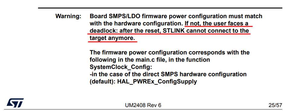

2025-02-13 2:20 AM - edited 2025-02-13 2:21 AM
@PMath.4 wrote:Why? - Who knows - a bug in ST-LINK V3?
No: a misconfiguration of the Target microcontroller - as @Kier cited:
The fix:
#PowerConfigCantConnect
