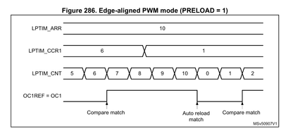

On the LPTIM, when CCRx=5, interrupt happens when CNT changes from 5 to 6. So if CNT=3 and you want an interrupt when CNT changes to 5, set CCRx=4.
Per the reference manual:
At least that's how I interpret it, and it matches the observation.

Originally I thought it was completely broken when I tried that, but that was because I did not wait for the changes to CCR* to be picked up by the LPTIM before checking if the counter was still within the bounds. But now that I fixed that as well, everything works perfectly. The reference menual could be improved though; this figure is in the PWM output section. Which makes sense as I'm using the output compare register, but I'm definitely not doing PWM.
