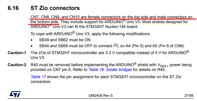

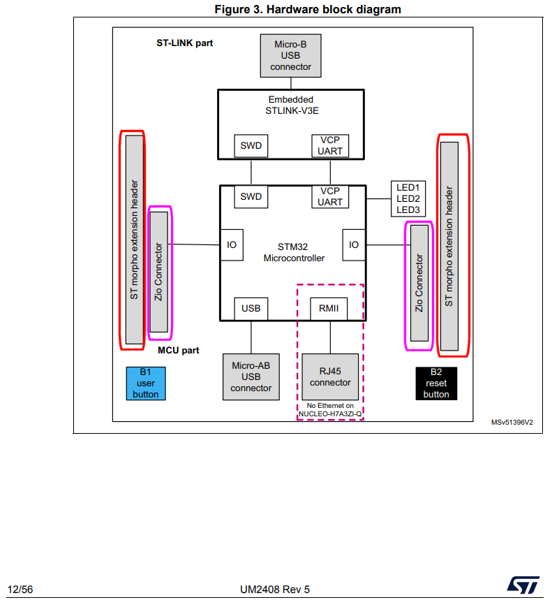

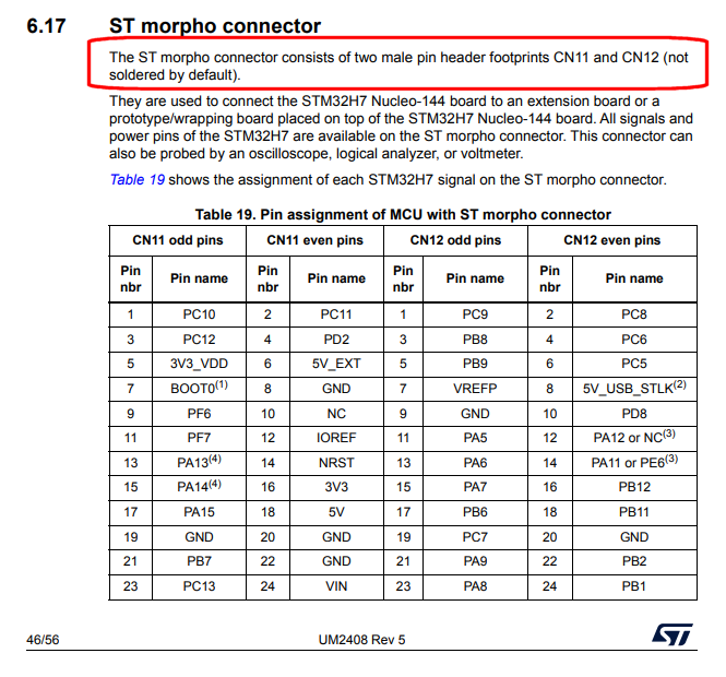

But can I just access these the same way as on arduino or esp32? For example just solder a female header on st expansion header and use it as normal on esp32 or arduino? How many are actually available and not reserved for other stuff?
2024-08-07 8:05 AM
Again, see the User manual:
