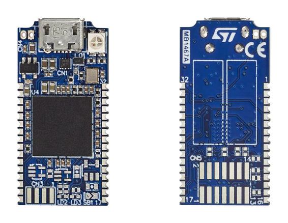

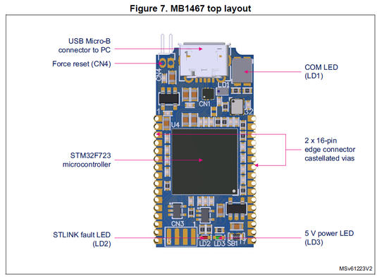

I have an STLINK-V3MODS debugger, and I want to solder the 14-pin target JTAG socket. I see that there are messing components around when comparing the file "UM2502" page 13, Figure 7. MB1467 top layout to my real debugger. I see lots of missing components around. If there are some missing components that I need to populate, could you please provide me with the required components ?

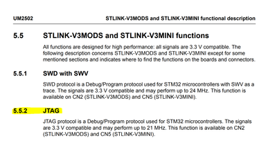

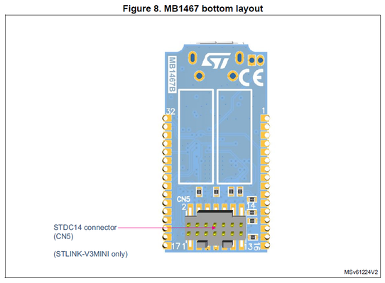

JTAG protocol is a Debug/Program protocol used for STM32 microcontrollers. This function is available on CN2
(STLINK-V3MODS) and CN5 (STLINK-V3MINI).
The "Voltage Translator reference design for STLINK-V3MODS" document has the reference to connect an external STDC14 connector to the STLINK-V3MODS board.
