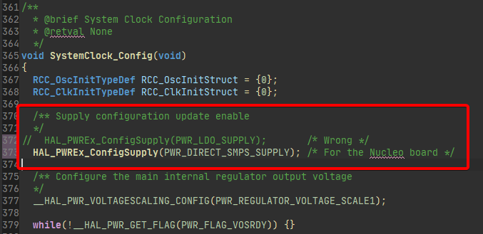

You're supposed to be using the SMPS power supply setting not the LDO.
How to recover, add jumper pins between BT0 and VDD, bridge jumper, remove and apply power connection / USB a couple of times, open / connect in STM32 Cube Programmer, and Mass Erase devices. After erase you can remove the jumper.

/*!< Supply configuration update enable */
HAL_PWREx_ConfigSupply(PWR_DIRECT_SMPS_SUPPLY); // <<< DO THIS, NOT LDO

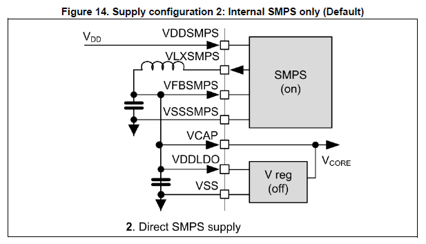

The -Q boards use SMPS
The H755ZI-Q is the crypto/hash version of the H745ZI-Q
You're doing this
https://github.com/AngryCarrot61/NUCLEO-H755ZI-Q_001/blob/main/CM7/Core/Src/main.c#L172
BT0 (BOOT0) and VDD jumper. Bridge with spare jumper, and power cycle board completely twice.

Thank you very much!
This solved the problem.
Note I could erase the chip without the jumper in STM32CubeProg using mode Power down.
I tested with the jumper and it works very well.
And the code is executing again.
I bought you a coffee!

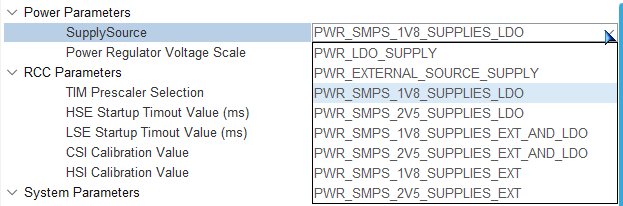

I found this in the board user manual:
If a deadlock is faced due to a mismatch between the
hardware board setting and the firmware setting (LDO/SMPS),
the user can recover the board by doing the following:
- Power off the board
- Connect CN11 ‘BT0’ pin (BOOT0) to VDD using a wire
- This changes the BOOT0 pin to HIGH instead of LOW and
thus the device boot address is changed to boot address 1
making the bootloader starting in System memory, instead of
starting the firmware in the user Flash (Firmware that is
setting a wrong LDO/SMPS configuration)
- Power on the board and connect using STM32CubeProgrammer
- Erase the user Flash
- Power off the board and remove the wire between BOOT0 and VDD
- The recovery is now completed and the board can be used normally.
Notice that STM32CuneMX 6.9.2 (the lastest) doesn't let you configure it correctly, you have to do it manually.
