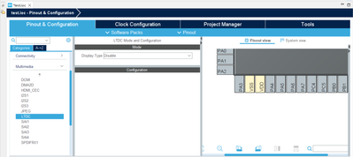

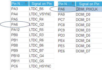

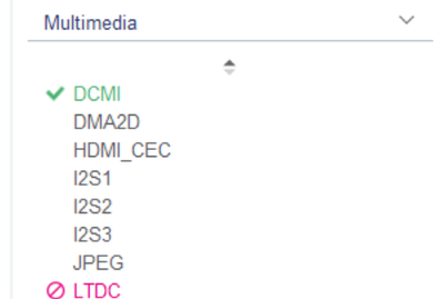

I am trying to use DCMI to connect the camera and display the video on LCD by LTDC. But it seems to me STM32CubeIDE does not allow me to active both DCMI and LTDC at the same time, because PA6 pin conflicts. And it seems the PA6 cannot be mapped to any other pin under DCMI and LTDC on the board Nucleo-H743ZI2. Does anyone have the same experience? How to use DCMI and LTDC at the same time? If the ST new released board does not have this conflict issue? thx.

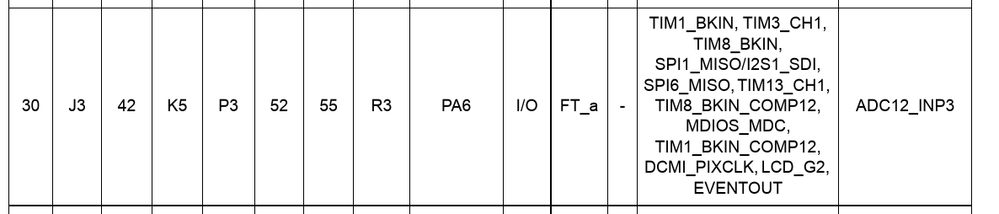

from ds , pins :
If no remap for LCD_G2 possible - you cannot use both here.
For example : remap on PH13 or PJ9 - but need case with more pins, that has PH or PJ port. (LQFP176 or 208 )

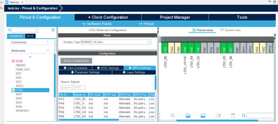

2024-06-30 2:11 AM
The CubeMX does not allow me to just remove G2 from LTDC. I first select RGB565, then PA6 (LTDC_G2) is set up.
Then I reset PA6, but the whole LTDC will be disabled. Shall I manually remove G2 in the code? Thx.

2024-06-30 11:54 PM
just another way to try it with Cube:
make new project, but set H743II (176pin LQFP ); set same clock tree and other things as on H743ZI ;
now set on LTDC the G2 to PH13 ; then set DCMI ...
now LTDC and DCMI active, here flashed on H743ZI ; now PH13 is used (going to nirwana...):
Try...
