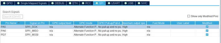

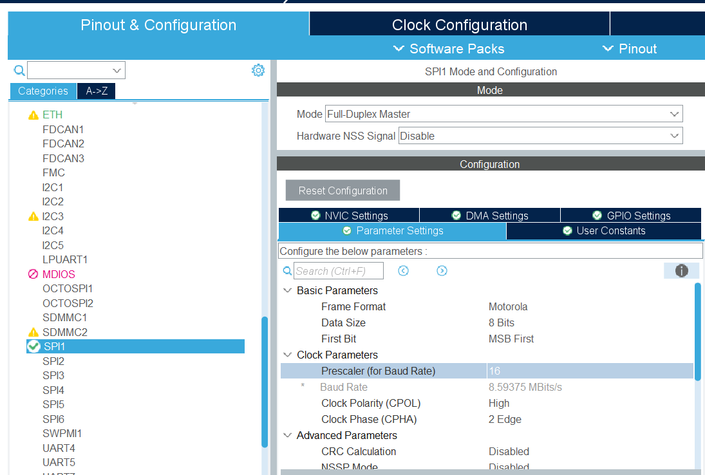

I'm new to embedded programming, and I'm currently working on establishing a basic SPI connection between an STM32 microcontroller and the BMI270 IMU sensor by Mikroe. My goal is to read the Chip ID (CHIP_ID register at 0x00) and get a response of 0x24, which confirms proper communication,Currently, I'm not getting the expected 0x24 and instead receiving either 0x00 or 0xFF when reading the Chip ID. Any guidance on what might be wrong or missing in my setup would be greatly appreciated, please see code work flow .

- Full-duplex Master
- Frame Format: Motorola
- First Bit: MSB Frame format
- Prescaler: 16
- BaudRate is 8.59 MBits/s
- CPHOL: High
- CPHA: 2 Edge

Physical Connection STM32 -> BMI270

0x00 or 0xFF suggests the board is not responding. Perhaps it is not powered, or not wired correctly. Your wiring table is correct, but power is not shown.
Code looks fine.
During debugging, reduce the clock rate to 1 MHz or less to eliminate noise as the issue.
Picture of the setup might help.

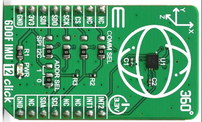

@mendicantbias wrote:I'm currently working on establishing a basic SPI connection between an STM32 microcontroller and the BMI270 IMU sensor by Mikroe.
Do you mean this https://www.mikroe.com/6dof-imu-12-click ?
Note that the BMI270 IMU sensor itself is by Bosch Sensortec - not MikroE:
https://www.bosch-sensortec.com/products/motion-sensors/imus/bmi270/
MicroE just make the board on which the sensor is mounted.

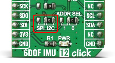

The board seems to have an option to choose between SPI and I2C:
Are you sure sure that you have the correct selection?
