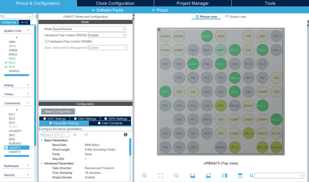

#endif /* USE_FULL_ASSERT */Pin configuration and the settings are as follows:

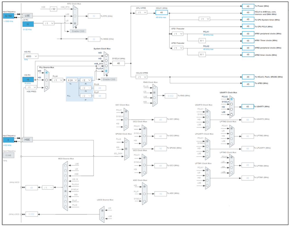

Clock configuration:

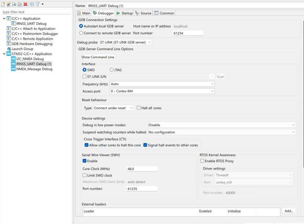

Debugger configuration:
