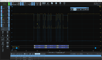

I'm writing the same command from the ST board as I was sending from Python, from UART to a Seeed RS232 adapter. Scoping signals at this point shows them to be ok, whilst not connected to any serial device, yellow being UART and blue, RS232.

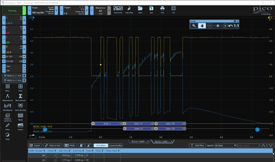

However, once I connect to my Fluke device the signals are corrupted to the point if illegibility:
I have reproduced the behaviour using a second UART -> RS232 interface and also switched out the Fluke device for another one from a different manufacturer, but no change in behaviour.

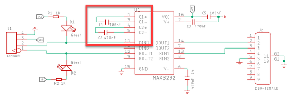

The Seeed interface can be found at 103990363 Seeed Studio | Mouser United Kingdom and uses the MAX3232 chip, whilst the Mikroe one is at MIKROE-222 Mikroe | Mouser United Kingdom and uses the MAX232 chip. There is a slight difference with how they arrange the capacitors which has some affect on their behaviour.

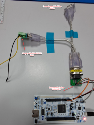

Thanks for getting back so quickly, I am utilising UART5 as highlighted below and taking 5V and GDN to the Seeed board. Grounding is commoned up from the STM32 through the Seeed interface and into the serial leads, I believe it is sufficient. Any scoping has been done with connection to this ground.
I hope the image below is sufficient to show what I am doing, I'm using a serial splitter to scope the output of the RS232 interface.
The Fluke device is a 6102 micro bath, I have no definitive spec of it's internals unfortunately beyond a reply from their technical support saying they use roughly 2µF capacitors in relation to their MAX232 serial setup.
The Seeed chip uses 0.1µF, could this potentially be an issue?
