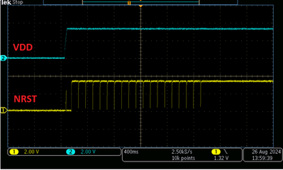

I have Nucleo-F767zi . When I give it an external power source through Vin. It doesn't always wake up. The board works if I reset it.
The graphic of my power supply;
It arrives 9V at 400 mili seconds. The curve is almost linear.(No glitch on the wave.)
There is no issue if I use USB.
I switched up my external power sources. However, the outcomes remain the same.
Is there a recommendation?
Thanks

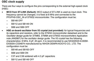

And the user manual (UM1974) for nucleo boards where it states:
So it by default uses clock from the ST-LINK, X3 isn't assembled on the board and left empty.
It seems as it takes a while for the MCO to output the clock at power-on, with a reset the clock is powered on already and it therefore works.
This is also why it works if one connect the USB cable first and then power on E5V, then the clock pulse is already there and the board can boot up as normal.
If one doesn't want to be dependent on MCO one have to solder on the board to fit X3 and the capacitors and also set the correct solder bridges or use another external oscillator, or use the internal clock HSI.

2024-08-26 10:14 AM
So what does the ramp-up of the actual supply (3V, or whatever) to the STM32 look like?
@Yilmaz wrote:The curve is almost linear.
You think so? :thinking_face:
Looks exponential to me - tending towards around 13V.

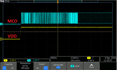

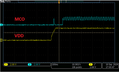

We have putted X3 and capacitors. And Changed resistors.
Before Configuration Changes, Our Scope Outputs;
(External 12V Power)
After Configuration Changes Our Outputs; (External 12V Power)
2024-09-11 7:16 AM
Don't know if I fully follow, are you still facing problems?
If you have soldered on X3 and the capacitors.
I think you should only need to do some solder bridge changes:
Open SB149
Close SB8
Close SB9
