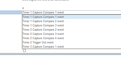

I have configured the ADC as shown below:
in the external trigger I have set "Timer 1 Capture Compare 1 Event" now this where the confusion is. What this trigger source means that every time there is update event on timer 1 it will trigger?. also I want more explanation regarding all these trigger events with a diagram would be great:

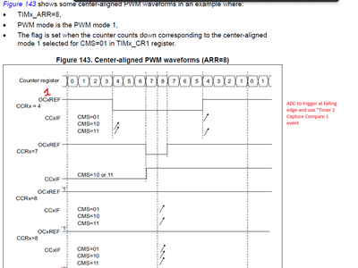

Figure 143. "Center-aligned PWM waveforms" in Reference Manual RM0390 Rev 6 is your friend. Choose an OCxREF for TRGO. You can use CH4 for adjusting the sampling point. Choose rising or falling edge (or both) in ADC trigger.

does the channel 4 of Tim 1 can trigger ADC? as I dont see as an option please see below
also OC1REF refers to channel 1 and OC2REF refers to channel 2 If i am correct.
please check the above diagram if it is correct.

You're right, TIM1 can't. However, for TIM2, TIM3, TIM8 you can select OC4REF.
