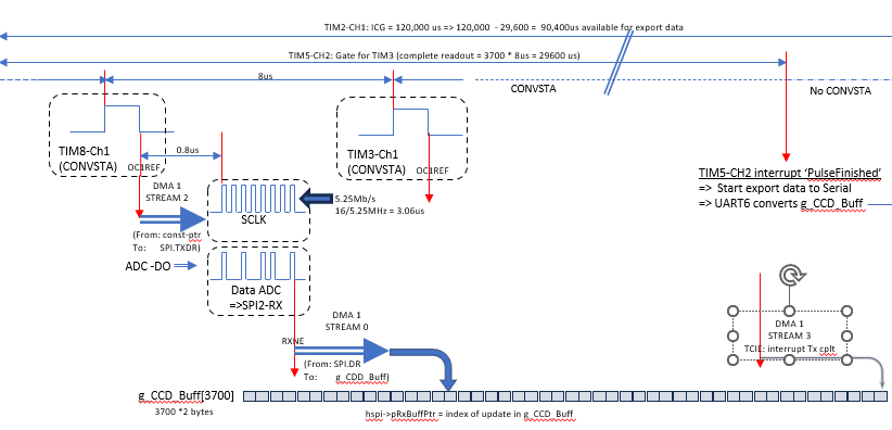

As engineer who started to explore the world of MCU's years after my retirement, I regularly encounter problems that puzzle me for some time. However, since I'm stuck for several days now, I decided to ask for assistance by this forum.
For my project, I selected a high-performance MCU, (STM32H723VGT6) mounted on a WeAct test-board, because of its price and atractive form-factor.
I want to digitize the analoge output of a linear CCD by an ADC with SPI interface. This ADC (ADS8319) needs a rising edge to start a conversion and >1.6us later it expects a serie of 16 Clock pulses to export its data. I have read an attractive solution for such challenge at the 'StackExchange' site, that sends dummy uint16 data to a SPI with DMA, triggered by a Timer.
A SPI in Full-Duplex mode, will produce 16 Clock-pulses to transmit an U16 word. The Timer must produce PWM pulses with the wanted frequency for the CCD readout. The rising edge of the pulse will trigger the ADC conversion, while the falling edge triggers the DMA transfer of a dummy uint16 to SPI, that produces the Clock-pulses needed by the ADC to export its data. The ADC's uint16 data is sent to the SPI MISO pin, to let it be transferred to the global data-array by another DMA action. The scheme below shows the timing:
Unfortunately, the organization of DMA on my MCU (BDMA, DMA with Mux, MDMA) is different from the STM32F746 on the 'StackExchange' forum, meaning the shown code snippets cannot be copied.
I configured SPI2 as Master in Full-Duplex mode with HW NSS signal handling, set 16bit frame-size, the baudrate and MSB-first. Despite many changes and different approaches, I have not been able to make SPI2 produce Clock-pulses, while the task looks quite simple: define and start a DMA action which, triggered by a Timer-compare event, writes a uint16 value to the SPI2 TXDR register.
I sincerely hope I made myself clear and that some readers are willing to think with me about how to crack this problem. Thank you in advance,

Dear Roman,
Thank you for your reply on my question, I really appreciate you took your time for it.
I'm sorry to say, I don't understand how your suggestion in the first two lines of your reply should work. I can configure SPI2 with DMA for transmission (Tx) and reception (Rx), but have not a clue how to connect my ADS8319 ADC to this configuration to achieve readouts of the ADC (which should be about a fixed number for a known fixed analoge input).
In your second alinea, you mention "implement TIM8 OC or PWM interrupt handler". My question just arose from the wish to bypass the use of interrupts on this time-critical appliance.
I would prefer a solution with a tiny, fixed delay, identical to the subject in a threat of another forum:
From the suggested solution I understood the following concept:
I understand most actions described above and know how to implement them. But I I cannot figure out how to define a Timer-DMA to perform its action on a SPI peripheral.
Or, in case I understand it all wrong: how I can let a TIM8- OC1 event trigger a SPI-Tx DMA to execute.
I hope I made myself more clear now,
best regards,
Fred Schimmel

Dear Barry,
Thank you for your reply.
I will try to give my reactions on the four sections of your reply, one by one.
About 1): I have learnt the trick to transmit a dummy word on a Full-Duplex SPI to force the SPI peripheral to produce clock pulses that are needed for the ADC to output its conversion word. And the SPI-Rx side receives the ADC word and transfers that data to an array. It was mentioned that "Receive Only Master" expects external clock-pulses fed to its SCLK pin to synchronize. I may experiment with your suggestion, but in that setup I still need to trigger the SPI-rRx action to read the ADC data (which I don't know how).
About 2): In my text I didn't explain the complete setup of the application. There are 120,000us are needed for the complete readout of 3700 CCD-pixels. It takes 8us to convert a pixel, so 3700*8us = 29,600us for digitizing all. In the past I encountered problems with the export of collected data as ASCII stream, converting new data, so I decided to do it sequentially. Writing 3700 uint16 values as hex ASCII chars on a 921,600 Baud port takes ~80.3ms => one complete readout takes 109.9ms, rounded to 120ms.
About 3): Apparently, I failed to explain my reasoning (valid or invalid). I want to use the TIM8 PWM for two things:
The SPI clock frequency is only important.to be fast enough to read 16 bits from the ADC within 8us - ADC-conversion time (= ~6.2us), but not too fast to allow my HW to keep the pulses separated. And, as I already made clear, I want to read 3700 samples, per cycle, not one.
About 4): Maybe I'm wrong, but in my perception the suggested solution in the stackexchange example defines a Timer-DMA that is triggered by TIM8.OC1REF, just as you describe in the first two sentences of your point 3.
The next step is to configure this DMA transfer for another peripheral (SPI2), by the specification of the address of a uint16 constant as 'source pointer' and the the address of SPI2.TXDR as 'destination pointer'. Until here I think I understand this approach, but I miss how to program the last part: how to start the Timer-DMA.
I hope I finally managed to make clear my ideas,
many greetings from the Netherlands,
Fred Schimmel

Dear Barry,
Thank you for your extensive responses on my reactions.
About "It was mentioned that "Receive Only Master" expects external clock-pulses fed to its SCLK pin to synchronize. This is wrong. The definition of "Master" in SPI is the side that controls SCLK.":
This is new for me and very good to know, thanks.
About " > In the past I encountered problems with the export of collected data as ASCII stream, converting new data, so I decided to do it sequentially. & > Writing 3700 uint16 values as hex ASCII chars":
I didn't express myself clearly. I could create a stream of bytes that, grouped 2 by 2, represent the uint16 values from an ADC. My main issue were: a) how to group the bytes to uint16, b) how to distinguish the start of a new CCD readout in the stream of numbers and c) how to recover from hickups (rare, but nasty).
About "> It takes 8us to convert a pixel, Where did this number come from?":
This was a wrong statement. You are right, the conversion + readout only takes 1400 + 600ns. Instead, it is the timing of the CCD itself that determines the 8us rep.rate. This can be increased, but in this stage I chose to take my time for the various steps, this may be changed later on when I get the system working.
About "> on a 921,600 Baud port takes ~80.3ms => one complete readout takes 109.9ms, rounded to 120ms. &
FYI, USB->Serial ports can easily run at 1/2/4Mbps and even 8Mbps. The STM32H723 also has HS USB which can easily do 16bit*500ksps.":
I experienced such high speed streaming before, with an 'USB_OTG_FS' peripheral, but didn't manage to reproduce it, so I chose to apply an UART, which documentated max speed is 921,600Baud.
About "> Each new pulse should trigger a new conversion of a CCD pixel voltage, where the period is determined by the ARR register.":
The mode you suggest ("3-wire without busy") was/is my choice also.
You state: a conversion is started whenever CSn is deasserted (the SPI bus is idle). If you time your SPI read till at least tcnv later, you can have the STM32 read out the data at 33Mhz. All you need to do is figure out the right period in which to trigger the reads, and anything more than ~2us should be ok.
This is just where I want to apply TIM8-CH1 for: the PWM pulse is connected as CSn (also idicated as CNVST) and the OC1REF event must invoke the SPI-RX DMA (I learned this from you, so SPI mode must be 'Receive, Master Mode') to read the ADC data. The pulse length is tuned to the required delay (<=2us).
About "> I miss how to program the last part: how to start the Timer-DMA.":
I will follow your instructions carefully and report my results after I testing.
Thank you very much for your attention for my problem, I really appreciate it.
Greetings from the Netherlands,
Fred Schimmel
