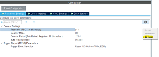

My first issue concerns the TIM6 configuration. When setting the Prescaler to 64-1 and the Counter Period to 125-1 in STM32CubeMX, the generated code includes something like "64 - DEFINE...". I had to manually modify the TIM6 configuration in the generated files to set the Prescaler to 63 and the Counter Period to 124 to resolve this.

For the first issue, I'm able to reproduce the described misbehavior. I reported it internally.
But in the meanwhile, you will need to change the cell parameter to "No check" as described in this post and shown in the screenshot bellow.
