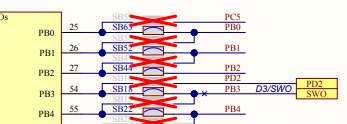

I have a NUCLEO-L452RE-P, on the box and on the user manual (UM2206) it show that PD2 is on CN5.4 and PC5 is on CN6.6. But the STM32L452RET6P doesn't have those pins (PD2 and PC5). To what are connected CN5.4 and CN6.6 ?

The 64-pin (P / SMPS) devices lose a number of GPIO pins. These obviously don't make it then to header pins, but the board is usable with multiple parts. You'll need to review the appropriate documents, or portions of documents, salient to your specific device, rather than the others / general ones.
First stop, probably schematics https://www.st.com/resource/en/schematic_pack/mb1319-l452re_p-c02_schematic.pdf

see schematics, as Tesla recommended:
pins are on pin header, but open sb, so not connected for this cpu.
