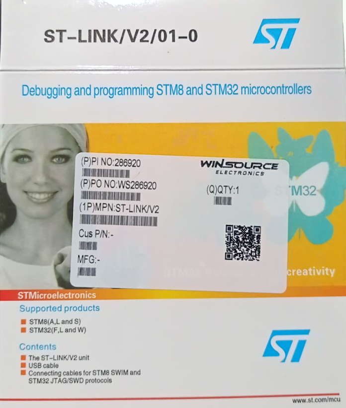

My company just purchased 10x new STLINKS in WINSOURCE.

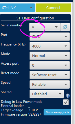

We are having trouble using them with newer versions of STCubeProgrammer(v.2.10.0)
,they work fine with the old STlinkUtility.

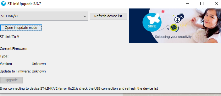

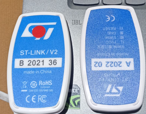

I am also unable to upgrade the Fake STlink:

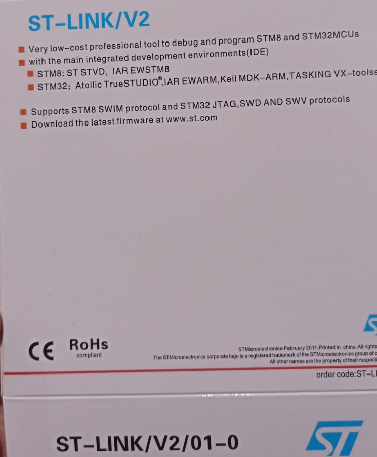

The BOX seems legit:

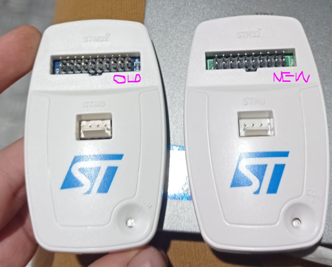

The plastic molding looks alright also, the back sticker is upside down.

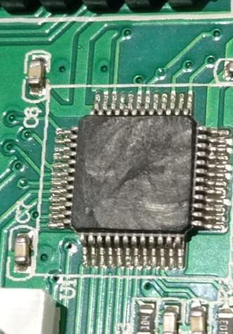

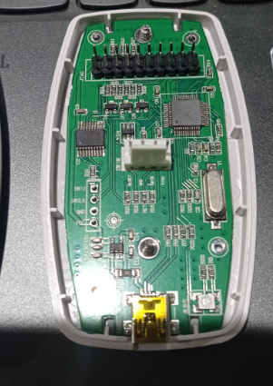

Once i open the new stlink, i notice the mcu markings are erased.
2022-12-20 11:53 PM
Everything you have analysed points to a counterfeit. The "ST" logo on the front is also stretched vertically. But at the latest in view of the abraded marking, it should be clear that this is a fake.
The only thing to do is to send the parts back to the seller and demand a genuine replacement or the money.
Regards
/Peter

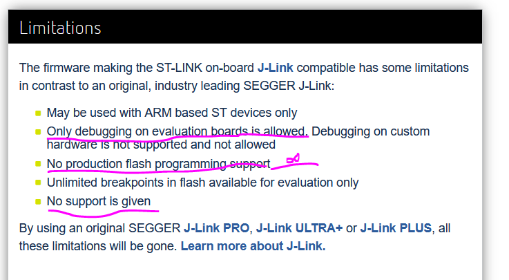

2022-12-20 2:54 AM
Hmm... Maybe, try this on it?
2022-12-20 3:05 AM
thanks @Pavel A. , lets try this.
I am not sure it will fix my issues, people in production use a lot the "automatic mode" from stmcubeprogrammer, this mode works slow/hangsup with the fake stlinks.
Edit:
I dont think im going to even try it, taking a look at the limitations:

2022-12-29 5:13 PM
If the hieroglyphs on it is not a big enough sign of being fake, then I don't know that is. And also a Chinese company cannot be a legit distributor...
