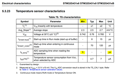

47.5 cycles at 36 MHz is not enough time to read the temperature sensor per the datasheet. Increase sampling time to max, or at least a value that satisfies the > 5us requirement.

Your board runs off of 3.3V (per the user manual), while the calibration values were taken at 3.0V (per the datasheet).
You can adjust for this by scaling your ADC value by 3.3/3, so use 1000 instead of 909.
