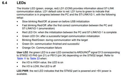

I am using nucleo f446re board.Whenever I run some code in debug mode RGB led which will simply run around the code will simply go turn off not entirely mild red can be seen.how to fix it?
But when we flash it and run RGB light turns to bright red.

LD1? You can see its operation in the user manual. You do not have control over this LED. Solid red indicates a connection to the PC.

Asper screen shot if the RGB light turns to orange color, it indicates communication failure.so how to check this case is not here any code by flashing that we can see that case
